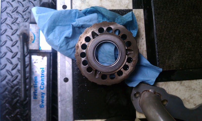

    trans part
    Here is the picture of the stock part from the J&W trans that got us DQ if you saw the race you would know this part did not win the race.The rule book reads a stock turbo 350 trans this a stock part which has been drilled . the rule book doesn`t say you can not drill a stock part also a STOCK trans doesn`t have a manual valve body but you are allowed to changed that ?

      In a rule book if it does not say you cant do it does not mean you can.
      A stock part mean stock unless the rule say you can make changes to it.
      . I guess the main question hear is why would you take a stock part and drill hole in it unless it will help you win races other wise you would have left it stock????
      GAry Laplant
        Due you really think drilling out 10 oz. of metal is going to make a difference and thats how we got the trans ,it was unknow to us that it was done
        Nelson Hernandez
          Well if someone takes a stock part and alters it for some reason it would have to be for a very good reason or you would leave it stock this is common since. Is that the only part you were DQ on in your trans??????
          Bur to answer your question yes the drill hole does make a differents on that part.

              Rotating weight is rotating weight! Yes it does make a difference or they( Jw trans) would not do it.
                You are correct Deuces on the 'rotating weight'. And if this part has been 'altered' then you know others have.
                Stock means stock.. the rules state that even if is not mentioned, don't do it.

                  lol You all are talking like ya'll have never cheated before! I can guarantee you that those lil holes that ya'll call rotating weight (.25 ounces) didn't win that race! If ya'll think that then we have a bunch of geniuses on our hands cause if you would've actually watched the race then you would've seen that truck get pulled on every restart so yea once again so much for "rotating weight". Don't get me wrong rules are rules and we all have to abide by them but you can't take away from Nick that he drove a perfect race and had a good truck!

                    What's a shame is that the fans watched a race, thinking someone had won, only to find out that the fool who crossed the finish line drove a cheater truck.
                    What's a shame is that the racer who finished second, legally, didn't get to enjoy the spoils in Victory Lane after the race.
                    AMFChassis - Rather than crying the blues for the cheaters, you should act like a professional outfit, and congratulate the guy who won the race, legally.

                        Seems kind of odd that you "had no idea it was in there", yet defending that it did nothing to help the performance.
                        You're pissed at the wrong people. The track didn't screw you, your transmission guy did. Claiming ignorance is not an acceptable excuse.
                          I will make this one statement on this matter !
                          I want to first say that the Hernandez crew handled themselves professionally in and after the tech. They did everthing we asked. The part your seeing is the only part that Carl pulled because he saw that first, and then looked in and saw drums were also drilled and lightened, but did not make them finish pulling it all out. The other transmission checked on the 41 came totally apart. There was not need to continue that. While I will say I do not feel that that part did not win the race, it still is not right and in combination with other light weight drilling in the other interior parts can make a decent difference. Carl did a very full tech, cc'd heads, checked cams and the transmissions. I stand by his decision, it is never my or his pleasure to DQ anyone, but I have promised to try ot make this event fair for all and we have teched. I also will try to do it for the 2012 series, and try to get costs back in line. Spending $2,000 on a transmission or more not sure of the costs, and having it not be right is a cost that needs to be cut back. I have nothing against JW Transmissions, but they do need to meet the rules we have to run by. I again say that I like Nick and his dad and that has nothing to do with this, I stand by Carls decision and I had the final say.

                            Ok,,,why Was The Transmission Checked? I Have Never Since A Trans Checked...

                              I agree with you on the cost has got out of hand on the trucks and what they have in them I hope we can get that back the way they were.
                              I was very please to see finally someone did check Trans on the trucks. Its not easy being the race director or the Tech on a big race like this. Both you and Carl did a great job on this race I am glad I was part of it.
