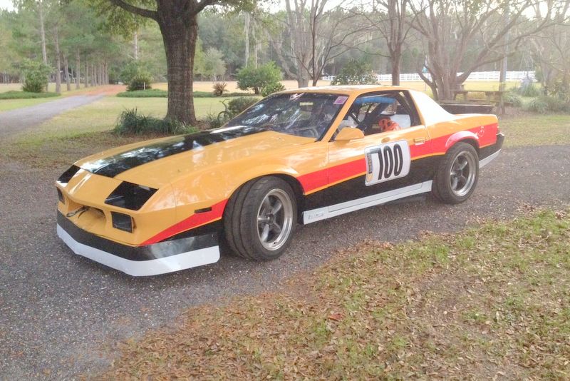

It does look very sanitary. The new hood fits well...
ps--Is it the photo or is the back window one of the parts that...de-parted?
pps--Plexi headlight covers in the future?Last edited by OldSchool+; 11-22-2015, 10:47 AM.
It's kind of a tribute to the Scott Sharp Duracell car back in the 80's. Used to love watching him mix it up with Roush's Whistler Mustangs!
We removed the rear window and small deck lid to take off some more weight(115 lbs.) and plan to replace it with Lexan sometime. It's a Hell of a lot cooler in there now but I'm sure it hurts our AERO package!
Headlights "holes" have an oil cooler behind one and a power steering cooler behind the other. We have the two small apex lights you see and two larger lights that can be bolted on quickly.
