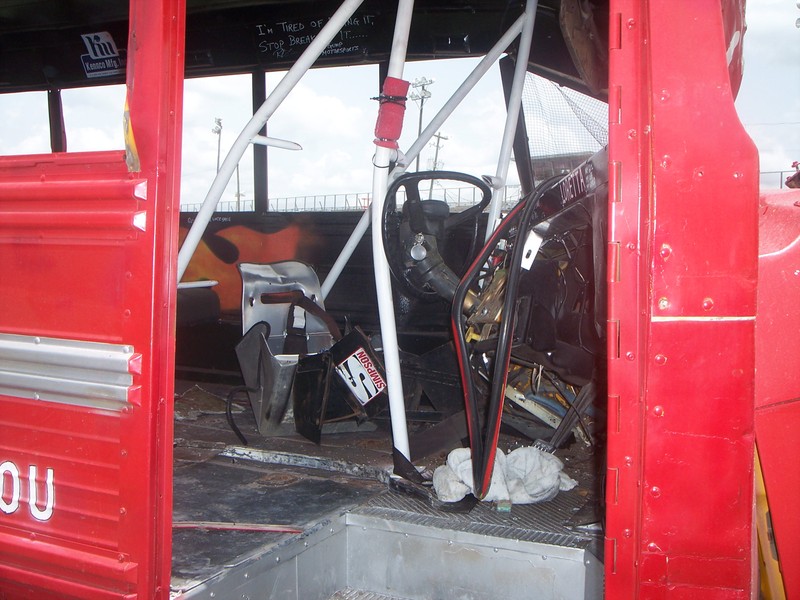

                    Photo of crash. I was hit on driver side by a bus driven by the track announcer. His throttle hung. He drove through the infield, hit me and shoved me into the wall wide open.
                    I was leading the race and was able to hold the bus at a steady 45 mph all the way around the track. I hit, climbed the wall and the fence. The track website at one time had a photo of the front of the bus at the top of the fence. Track workers parked just on the other side of the fence could see the underside of the bus. I was only wearing a lap belt sitting in the stock seat.
