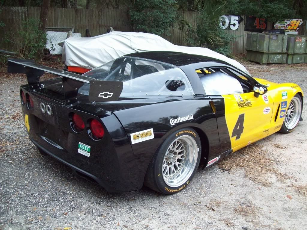

Pics of Bemco Fab built Corvette, nearly done
  • Pics of Bemco Fab built Corvette, nearly done
    Tube Frame C6 Corvette by Woody built to Grand Am Rolex GT rules & V8 StockCar GT-1.
    Schwanke Racing Engines LS6
    G Force T101A tranny
    quartermaster 7.25 triple disc clutch
    Speedway Engineering GN Floater with Cup Chunk
    Brembo 4 piston Nascar intermediate brakes
    Penske Shocks
    Howe upper & lower A frames
    Sweet spindles
    Complete Custom Wheels (CCW)
    ATL cell with dry break
    Crawford Composites wing
    roof is composite GA spec, rest of body is gutted, stock Chevrolet
    [IMG][/IMG]
    [IMG][/IMG]
      [IMG][/IMG]

              She's on her feet!
              [IMG][/IMG]

                          Curious about something... I see 3 Master Cylinder reservoirs. I understand seperate front & rear reservoirs, but is the 3rd used as a slave cylinder for the clutch?
                            yes, Jerry
                            Clutch master
                            • #15
                              [IMG][/IMG]
                              She weighed in at 2606 # with 10 gal fuel or about 2540 # dry. This is 35 # under for a stick axle Corvette under Grand Am rules. Not too shabby for a mostly stock body.
